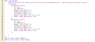

Hello together,
applying a simple JSL Gage R&R script, I would like to save this variability charts into the table by using the JSL "Save Script to Data Table". Unfortenately, this doesn't work:
This function works without problems on the graph builder, has someone an idea how it works succesfully on the variability charts?

Re: Save Script to Data Table JSL Script Doesn't Work on Variability Gage R&R Charts
Hi,
Please take a look at this post on how to save New Window scripts to data tables: save New Window scripts into data table
Thanks, this works, but I propose to simplify the Variability Chart Script itself so that the function "Save Script to Data Table" works on all the different graphs, charts, etc.
Michel
Please add your suggestion to the JMP Wish List, so it gets added to the official list of items that the JMP folks review for future enhancements.
Jim
