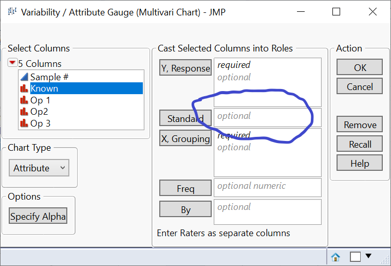

I've also attached a screenshot of the input menu that pops up when using the JMP Variability / Attribute Gauge Chart.
The title is different, but important to me is that I can use nominal variables in the Standard field.
My question is: What is the script syntax to get the same input menu that JMP displays? I’ve looked all over the Scripting Index, but no joy.

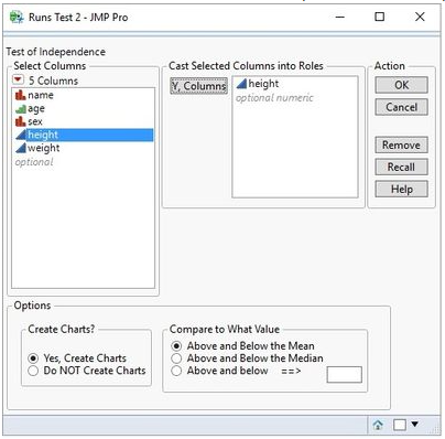

There is a JMP addin that I wrote a while back that has a pretty complete dialog box in it's JSL
Runs Test (Wald-Wolfowitz Test) and JSL Implementation of JMP Platform Dialog Box

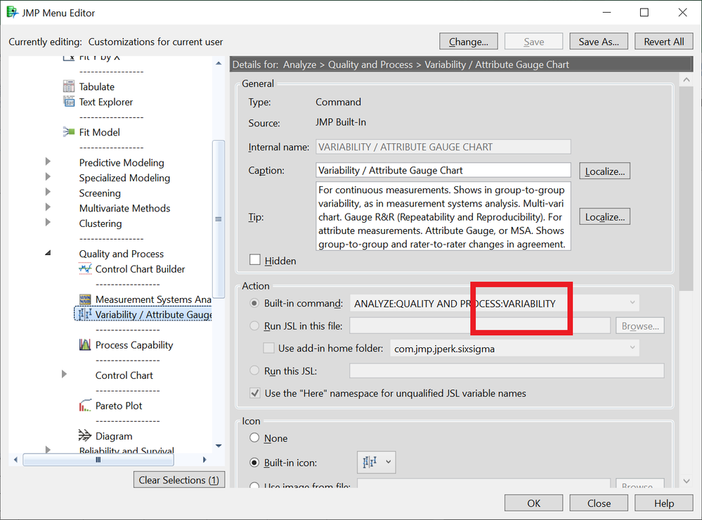

I am surprised that I needed to make this. I'm still wondering whether there is a platform command that someone knows. When I look at the JMP Menu Editor for this item, I would have guessed that the platform launch name would be "Variability()". See the attached for a screenshot. But, that doesn't work.
