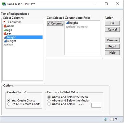

An implementation of the Wald-Wolfowitz Test, more commonly called a Runs Test.  This is a translation from a SAS Sample 33092 from http://www.sas.com website. It's output is a Run Chart (Control Chart) and a Results Table that contains the particulars from the Runs Test.
Also contained in the JMP Addin is a JSL implementation of an approximation of the user input dialog box used by most of the JMP Platforms.
It is a piece of JSL that can easily be stripped out and implemented in user's code

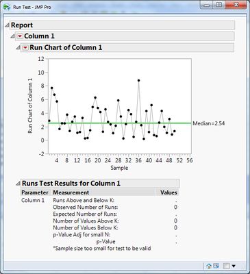

This doesn't appear to work if you select the median.11759_JMP Runs Test for Median.jpg
50 data points used
2.86183
7.68534
6.69476
5.69521
1.64778
2.48436
2.46675
3.75411
1.35445
2.71276
3.47636
1.08042
1.19898
3.26590
0.25385
0.32216
1.45118
4.87050
6.26643
4.74128
4.13786
1.24669
4.53740
2.68636
2.32268
1.02866
2.12435
5.85016
3.48550
0.25086
2.36367
4.42492
3.81540
0.48526
2.69943
8.78881
2.20214
0.19546
4.28811
1.19588
5.15606
0.74346
0.59323
2.58602
4.29810
1.95153
1.06895
3.11554
0.83567
1.33004
txnelson
I have fixed the bug....thanks for finding it.  I will be uploading it shortly
recremekim
Works fine now. Data is Chi-sq. with 3 deg. of freedom.  Thanks
