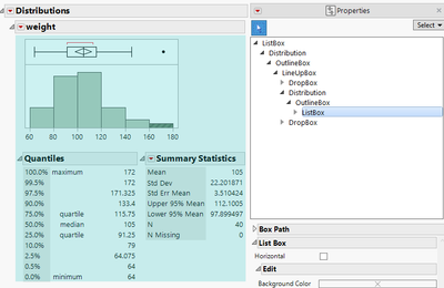

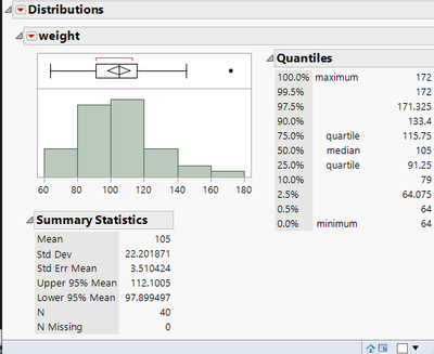

The distribution platform has multiple options and results that can be added, collapsed, and removed.
Is there a simple way to reorganize where they are? For example, moving a table below a graph.
It is common to have the results taking more space than the size of the window.

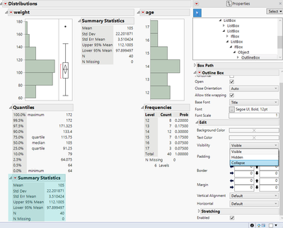

You can drag and drop it to create a copy of outline box but you will loose out on the red triangle (and getting the correct place is a bit clunky)
Same does happen when scripting
Names Default To Here(1);
dist = dt << Distribution(
	Stack(1),
	Continuous Distribution(Column(:weight), Horizontal Layout(1), Vertical(0))
rep = Report(dist);
sumstat = rep[OutlineBox("Summary Statistics")];
rep[OutlineBox("weight"), ListBox(2)] << Set Horizontal(0);
rep[OutlineBox("weight"), ListBox(2)] << Append(sumstat << clone box());
sumstat << Visibility("Collapse");
Moving both tables is bit easier as you can change change the List Box properties but I think this isn't captured by JMP either

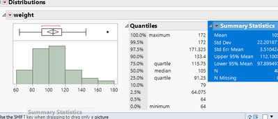

How can you drag and drop using your mouse?
Losing the menus is fine, as this is more for reporting.
jthi
Re: Re-arranging menus in distribution platform
Press "S" or use selection tool from toolbar
click on the outline box and drag it around. You will also have to hide the original one and I think it is easies to do from properties
