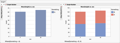

I'm using JMP17 on Mac OS. I want to create an Interactive HTML output of two charts, one filtered to a single value "A", one filtered to everything except "A". Simplified example code is given below.

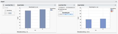

The window I get in JMP works as expected. However, the Interactive HTML doesn't: both charts are filtered for "A". I've tried a couple of different browsers with the same result (see screenshots below).

It seems that interactive HTML has some limitations. For example, there are two local data filters in your report. you may see the log (View>Log) message "Interactive HTML: Only one data filter per report is interactive" when saving as interactive HTML.
See also the following page. https://community.jmp.com/t5/Discussions/Issues-with-local-data-filter-interactivity-on-HTML/td-p/40...

The local data filters are also frozen because we can't support the Include mode (inclusion/exclusion of data) in Interactive HTML. For that, we need to reach back to a server containing a version of JMP to perform the necessary calculations to rebuild the graphs(and tables if there are any in the report). This is how JMP Live works.
Having said that, we strive to capture the output of the graphs to match JMP when they were exported, even if the Include mode is enabled and there are two or more Local Data Filters in the generated web page.  Since that does not appear to be happening, I will report this as a bug to be fixed in a future version. If a work around can be found, I will report it here. Or maybe another, clever JMP Community User will beat me to it.

Having more than one interactive local data filter (without the Include mode enabled) has been implemented in Interactive HTML for JMP 18 that will be available in March 2024.
I have tested the issue you described above with a development build of JMP 18.  With the Include mode enabled, the local data filters are still disabled, but the filtering of the right hand graph is correct. With the Include mode disabled, both local data filters are interactive in Interactive HTML.
