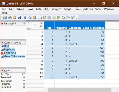

I have an RNAi dataset with 3 technical replicates that was done in triplicate.  For example:
Run 1
gene X  45
gene X  59
gene X  51
Control 90
Run 2
gene X  145
gene X  159
gene X  151
Control 190
Run 3
gene X  35
gene X  39
gene X  31
Control 50
The real dataset has hundreds of genes and dozens of controls per experiment. Each run tends to vary in its average, but the experiments were the same. I think this is due to room humidity, but it doesn't matter in the end. My interest is in the genes, not the run variation. I basically want to see which genes vary from control, and a probability (p value?). What is the best approach to analyzing this data with JMP?

  1. So does your table of data look something like this but with many genes?
  1. Is there only one control per run but three technical measurements of the same condition within the same run (like in the table above)?
  2. Do you have something like condition x is one experimental condition,  with three technical replicates for gene x, and you have many conditions for the experiment (condition x, y, z, etc.)?
  3. As many details as you can give the more accurate and appropriate my answer/solution will be.  Even what the output of your data looks like helps.

You are correct, my dataset looks like almost exactly like your picture, with 400 genes (gene x, y, z, etc) and some more metadata that is just for validating. (ie 96 well microplate location, the plate name etc)
