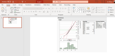

nw = New Window( "Output", (Report( plot )[Outline Box( 1 )] << get picture) );
nw << save presentation( "$TEMP\try.ppt" );
Open( "$TEMP\try.ppt" );
