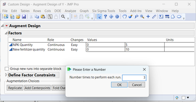

If you want to replicate the whole design 2 more times, you can use the "Augment Design" platform (in menu "DoE", "Augment Design"), click on "Replicate" option and specify 3 as the number of replicates :
You'll end up with a completely randomized design with 3 replicates, for a total of 24 runs (datatable attached).

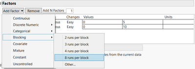

If you have constraints about number of runs done per day for example, you can use blocks in the initial design generation, by adding a factor (type blocking) and specify the number of runs per block :
You can then specify the same model as before (with added block effect), the number of runs in total (24), and you'll end up with a design in 3 blocks (see datatable attached).

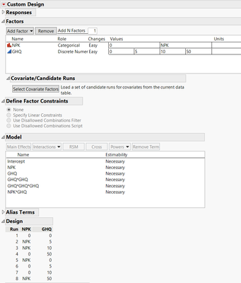

With your informations, here is how the setting of the factors and model can be done in order to get the 8 treatments you need :
To obtain this 8-runs design, here is the script :
DOE(
	Custom Design,
	{Add Response( Maximize, "Y", ., ., . ),
	Add Factor( Categorical, {"0", "NPK"}, "NPK", 0 ),
	Add Factor( Discrete Numeric, {0, 5, 10, 50}, "GHQ", 0 ),
	Set Random Seed( 1540555554 ), Number of Starts( 329553 ), Add Term( {1, 0} ),
	Add Term( {1, 1} ), Add Term( {2, 1} ), Add Term( {2, 2} ), Add Term( {2, 3} ),
	Add Term( {1, 1}, {2, 1} ), Set Sample Size( 8 ), Simulate Responses( 0 ),
	Save X Matrix( 0 ), Make Design}
Then, to have 3 replicates, you just need to use this design and go to "Augment Design", option "Replicate", specify that you want each runs done 3 times, and you'll obtain your 24 runs as needed (datatable attached). The script used to augment the design is :
