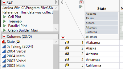

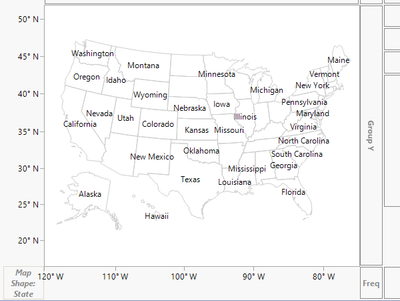

Set Label to column you want to show and then select all rows you want to have the label on and set labels on those:
and then create your map
