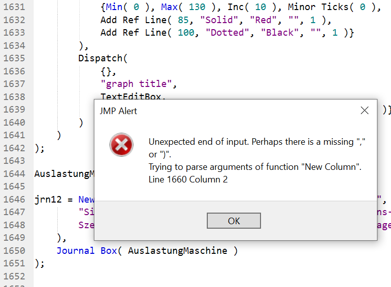

Hello,
I am using option called jmp debug to verifiy my script before start it first but I am running regular in issues to find bug because error message is not clear for me.
for ex:
my new script ends at line 1652 but I get error message regarding entry in line 1660 col 2.
any inputs?

You are most likely missing a comma, semi-colon, or parenthesis. These are not always obvious.
Depending on how the JSL is structured, I have found that the code folding feature of the editor is sometimes useful to help narrow the scope of where the problem is. Also, the indentation guides may provide some assistance as well.

When you put the text cursor on an open parenthesis, the matching close parenthesis highlights. You might need to scroll (with the scrollbars, not the arrow keys) to see the match. Works or the curly braces and square brackets as well, and works from either end.
The New Column hint is probably important; JMP thinks it is still inside a NewColumn( ... function and has not found a matching close parenthesis. It might be 1600 lines above.
