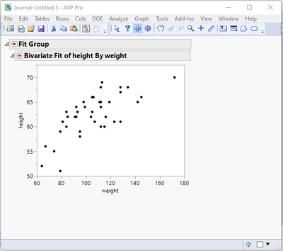

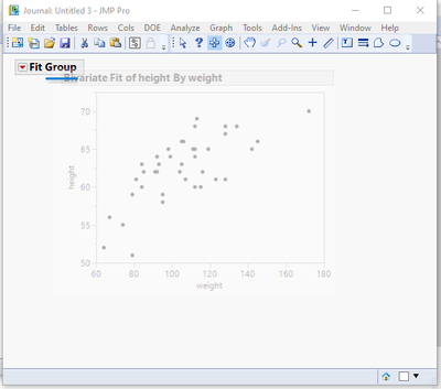

    1. Choose the Selection tool (the thick +) from the tool bar, or alternatively just press the S key.
    2. Drag it to the journal window, and position it under ne Fit Group outline boxtxnelson_0-1626258126734.pngtxnelson_0-1626258126734.png
    3. It will now be an element of the Fit Group outline box             txnelson_1-1626258214901.pngtxnelson_1-1626258214901.png

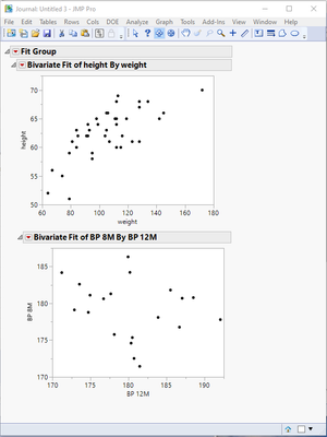

    2. Drag the display to the Journal window and place it under the output from the previous Fit Y by X txnelson_2-1626258707895.pngtxnelson_2-1626258707895.png
The combined journal has been created
