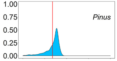

Good afternoon all,
I am looking to make a probability density function graph, how best can I do it using jump graph builder? How can the density (y) axis be scaled?
some like what I have attached in the image.
Thank you.

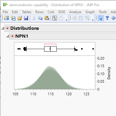

txnelson
Re: Probability density function_pdf
What you need to use, is the Distribution Platform.
Select the column(s) you want, then under the red triangle, select
     Display Options=>Horizontal
     Histogram Options=>Density Axis
     Histogram Options=>Shadowgram
