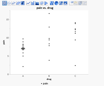

When i export graphs from GraphBuilder and the "transparency" in Preferences/Reports is "on", i get a very pixellated text:

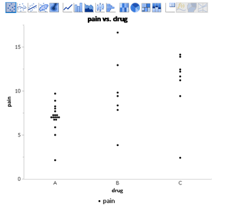

if I turn it off, it looks fine:
I want to have transparent backgrounds with the normal quality text. Would anyone happen to have a suggestion on how to solve this?
Another note - if i export it to PowerPoint, the text is good and the background is transparent, but export to file (via script) gives the pixellated picture, as in the example.

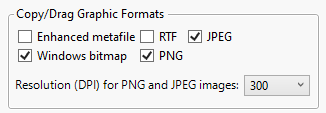

you could check under Preferences/Windows specific the resolution for PNG and JPEG export.
With "300" you will get a much better quality.
I am also a big fan of EMF export. On a Windows system you can even change parts of the plot later in Powerpoint.
To make it work, you have t o enable EMF copy/paste in the preferences.

Konstantinl
Level II
Re: Pixellation in GraphBuilder titles
Thanks for the replies! Gonna go with this one, because this saves a few clicks when inserting individual graphs somewhere!
