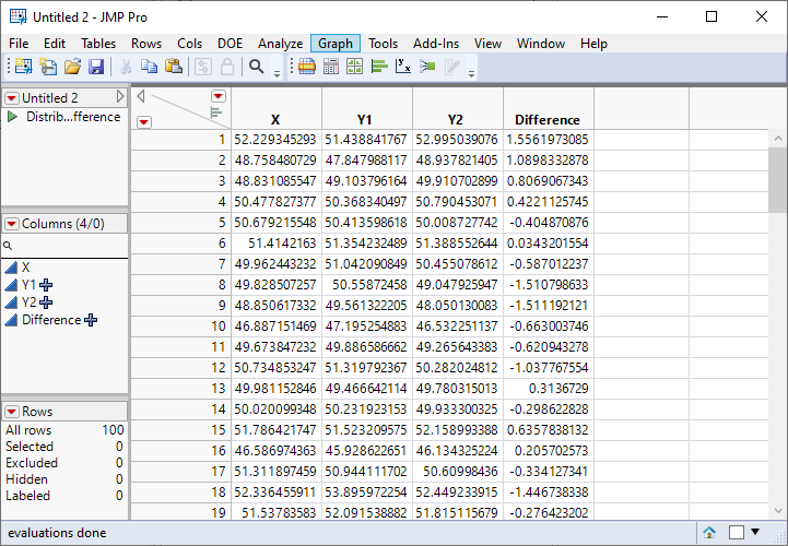

You generally use the Analyze > Specialized Modeling > Matched Pairs for this purpose, but this platform does not currently provide an equivalence test. For now, use a formula to compute the difference in the data table. I mocked up paired responses Y1 and Y2.

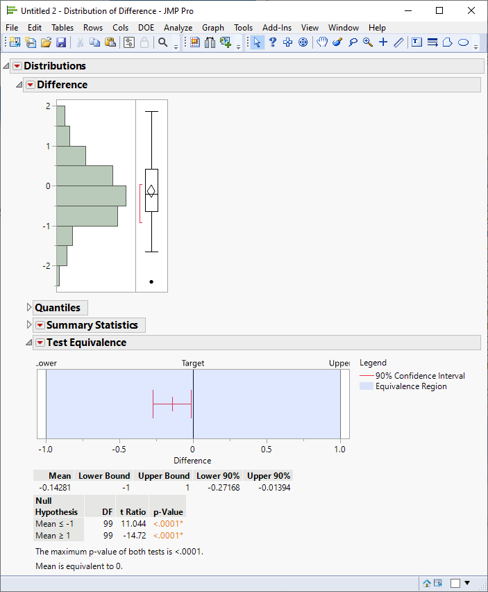

Select Analyze > Distribution and launch it with Difference in the Y role. Click the red triangle next to Difference and select Test Equivalence:
Specify 0 for the expected mean and whatever limit you use for practical equivalence. I claim that my example is equivalent if the result is within 1 unit:
Click OK, and you will get the result:
This example shows that these two responses are practically equivalent because the two-sided tests are significant and the confidence interval estimate of the mean is entirely within the +/- 1 interval specified.
