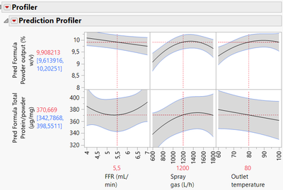

Yes, you can overlay profilers from different models and responses if the factors are the same (same name and configuration/type). Here are the steps you need to follow to have the combined profiler for any models and responses :
  1. From each model, save Prediction Formula (red triangle, "Save Columns", "Save Prediction Formula").
  2. If prediction columns are on the same file, you can click on "Graph", then "Profiler", and specify in the "Y, Prediction Formula" your two prediction columns. If they are not on the same table, you may need to move on of the two on the same table so that the profiler can be created with both formula.
You will obtain a Profiler with the two predicted responses you have specified :
If you would like to have also confidence range for each response, you also need to save in step 1 "StdErr Pred Formula" and include them in the Profiler panel in the "Y, Prediction Formula", and click Ok on the message "Use Column PredSE [...] to make intervals for [...], rather than profile it as own formula ?" :

Hi @harshnaik,

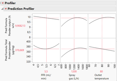

Hi Victor, thank you for the response. I tried this approach, but JMP doesn't let two responses have the same name, so the second model formula I saved in the table has a different name with a " 2" appended to its name by JMP. So in profiler platform it creates a second row for the two different models. What I was looking for was an overlay in profiler of the two models in the same row (I've seen its possible in other software like CEDA).
I guess its not possible to having two models in the same row, so this is the best possible alternative.

Ok I understand better your needs.
I'm afraid at the moment this option is not available. You can ask for this feature in the JMP Wish List : https://community.jmp.com/t5/JMP-Wish-List/idb-p/jmp-wish-list
In the meantime, you could perhaps create a residuals formula column to see the differences between your simulation model and your experimental model and visualize it with the Profiler ? To do this you may have to copy-paste in this new column both formula of the models, so that the residuals formula is linked directly to factors. It may help you assess if errors are equally distributed in your experimental space, or if you have area where you have significant differences between the two models that may need further investigation ?
