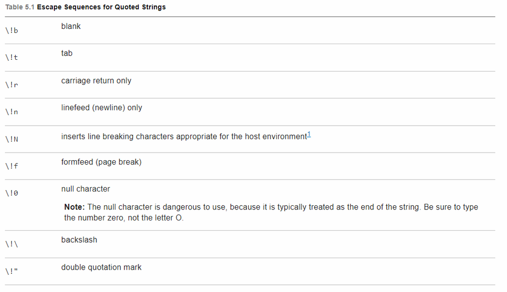

Line changing whitespace characters are not all the same which can cause some problems. Sometimes Words() can be clean option for something like this

In JMP
JSL Syntax Rules (jmp.com)
In regex (usually)

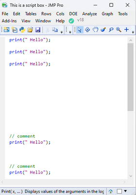

Given
It returns

nw = New Window( "This is a script box",
sb = Script Box( "print(\!" Hello\!");
// comment
// comment
print(\!" Hello\!");", 300, 100 );
sb << Save Text( "$TEMP/Test.jsl" );
nw << close window;
intText = Load Text File( "$TEMP/Test.jsl" );
substitute into(intText,hextochar("0D0D"), "\!n");
substitute into(intText,hextochar("0A0A"), " ");
substitute into(intText,hextochar("2F2F"), "\!n//");
nw = New Window( "This is a new script box",
sb = Script Box()
sb << Append Text( intText );
sb << reformat;
Jim
