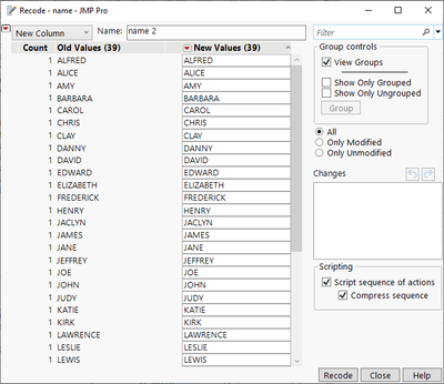

Is there any way to open the red-triangle menu for the selected pane using the keyboard?
In my case, I'd really love to get to the "Replace String..." option in the Recode menu without having to reach for the mouse.

I'm not sure if there is a shortcut to open that from recode.
But at least for me on Windows10 this works (requires multiple button presses).When you have recode open
press tab and it will highlight the red triangle
Then you can press space/enter/down arrow and use arrow keys to go to the replace string (or use the search).

Yes!  That works, thanks!
