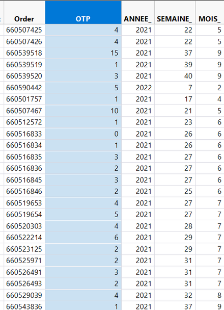

Hello everyone, I would like to know how to count the number of "OTPs" that are equal to 0 and make the division on the total number of LINES of OTP ? Thank you for your help

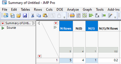

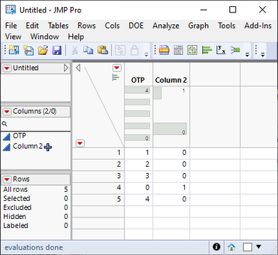

Create new formula column such as
:OTP == 0

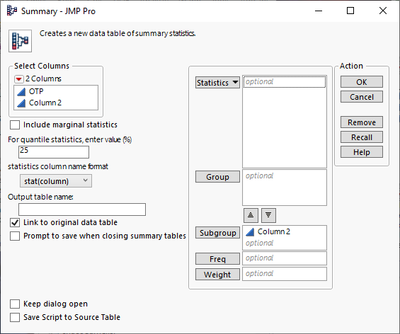

then use summary to create new table using the new column as Subgroup (remove link to original data table if you don't need it)

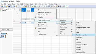

select N Rows and N(1) columns and create new formula column with right click menu:
