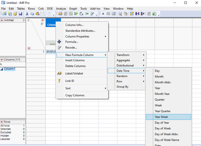

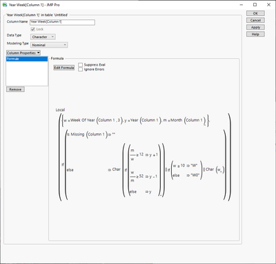

jthi
Re: JMP 16 Useable Year Week Column
One easy way to get "baseline" formula for this is to use premade formulas JMP has (if you have a date column):
-Jarmo
