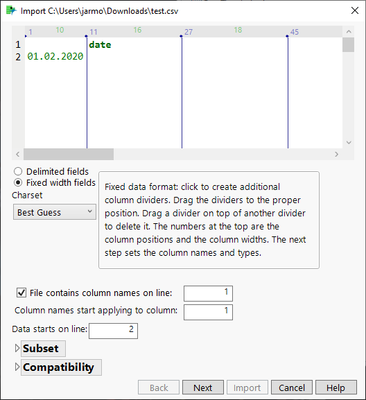

jthi
Re: Open/Read fixed width text file in JMP
Have you tried opening the files using JMP's Open with preview?
Select
find your file, make sure Using Preview is enabled and click Open
You will them get many different Import options you can change to (hopefully) fit your file format
After you are done with your selections and are able to press Import, press it and you can get the script from Table Script "Source"

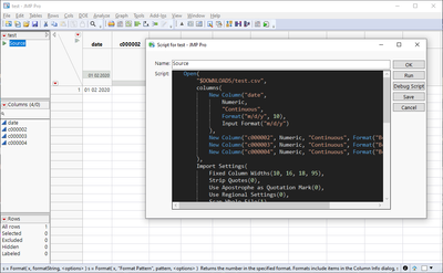

jthi
Open(
	"$DOWNLOADS/test.csv",
	columns(
		New Column("date",
			Numeric,
			"Continuous",
			Format("m/d/y", 10),
			Input Format("m/d/y")
		New Column("c000002", Numeric, "Continuous", Format("Best", 10)),
		New Column("c000003", Numeric, "Continuous", Format("Best", 10)),
		New Column("c000004", Numeric, "Continuous", Format("Best", 10)),
		New Column("c000005", Numeric, "Continuous", Format("Best", 10)),
		New Column("c000006", Numeric, "Continuous", Format("Best", 10)),
		New Column("c000007", Numeric, "Continuous", Format("Best", 10))
	Import Settings(
		Fixed Column Widths(13, 3, 7, 9, 11, 6, 90),
		Strip Quotes(0),
		Use Apostrophe as Quotation Mark(0),
		Use Regional Settings(0),
		Scan Whole File(1),
		Treat empty columns as numeric(0),
		CompressNumericColumns(0),
		CompressCharacterColumns(0),
		CompressAllowListCheck(0),
		Labels(1),
		Column Names Start(1),
		First Named Column(1),
		Data Starts(2),
		Lines To Read("All"),
		Year Rule("20xx")
Does have "$DOWNLOADS/test.csv", and Fixed Column Widths(13, 3, 7, 9, 11, 6, 90). Are these still missing something?
-Jarmo
