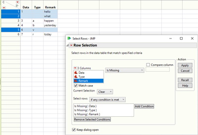

To add-on responses by @dlehman1 & @txnelson with images,
Easiest way is to use the GUI / user interface (see steps below).

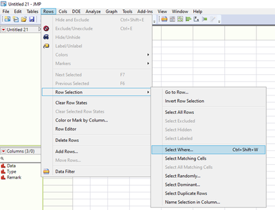

1) Click "Row" > "Row Selection" > "Select Where"

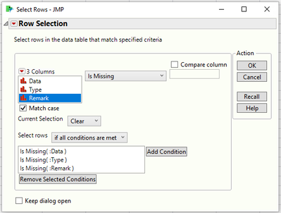

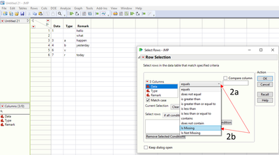

2) Select the column > Is Missing > Add condition
3) Repeat step 2 for all columns

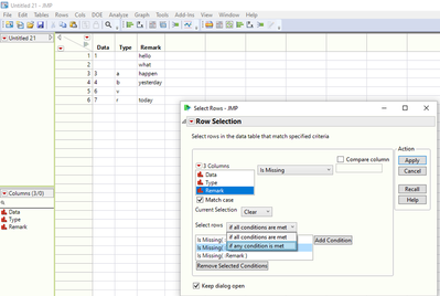

4) Select rows > choose if "any condition is met"
5) Click "Apply"
6) right click at table rows > choose "delete rows"
6) Result as below;

I'm not sure I am understanding your question, but as stated this is very easy to do.  Under Rows-Selection-Select where, you can choose any of your variables and choose Is Missing from the drop down menu and all those rows will be selected and you can then delete them.  This works provided that the entire row has missing data for all variables.  If only some variables are missing in some rows (different variables in different rows), then it isn't that simple - but that is a different problem and a case where I don't think you would want to remove the rows.

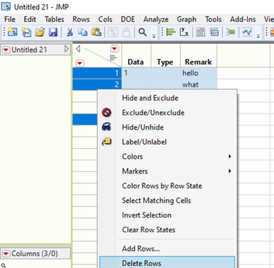

The way I do this operation is to right click on a cell on one of the rows that has all missing values, and then select, "Select Matching Cells".  It will select all rows that have a missing value for the cell in question.  Then you can simply move to the RowState column(row numbers column) and right click and select "Delete Rows"
