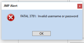

today I started working with a new script, and it seems to not be writing the Open Database() Errors to the log, but rather throwing JMP ALERT Dialog Boxes up .. which is sort of nice, but not quite friendly enough... and I would like to use my function to check for errors....
Is there some method of controlling if these go to the log or not??? The Only difference I can see in this new script I inherited is that it doesn't make any DB calls until AFTER the UI comes up ... If I make an Open Database() Call BEFORE the New Window is rendered and defined/populates.. the error is in the log... Interesting!! how can I make it write them ALL to the log..??

If the UI is presented, and the user is interacting with it.. all of the sudden these errors are not going to the log, but instead are displayed interactively..image001.png
Which of ‘course  results in further errors, because we couldn’t trap the error from the log like we have for all our other scripts…image002.png

I just performed a test on one of our other scripts based on what I am figuring out… and I DO see the same behavior….
Any DB Calls AFTER the UI is up and running, seem to present interactive JMP Alerts, but nothing is going to the log file..??
This sort of breaks my error handling….. and I’ll have to add more validation tests to check the DataTable returned I guess….??
Unless there is a way to force these errors to go to the log so I can provide more user friendly error dialogs…image005.png
