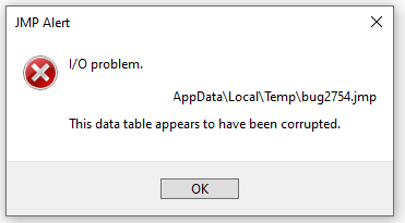

Re: Oops - I lost my data ...
option 2)  create a summary table
- with a link to the main table (default)
- with a compact column
dt = New Table( "input",
	Add Rows( 3 ),
	New Column( "ID",
		Character,
		"Nominal",
		Set Values( {"A_1", "A_2", "A_3"} ),
		Compact() // <- disable to remove the bug
dt sum = dt << Summary(	Group( :ID ),
//Link to original data table( 0 ) // <- uncomment to disable the bug
fn = "$temp\bug" || Char(random integer(10000))||".jmp";
dtsum  << Save( fn );
Close( dt sum, NoSave );
Try(open(fn), Caption("sorry, the file is damaged"));
When you try to open the file manually, JMP will display an error message:
