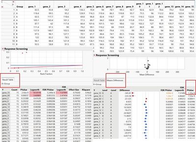

Hello:
I have a data set containing 15 observations in three groups/conditions (group 1: 5 observations, group 2: 6 observations, and group 3: 4 observations) for around 3,000 genes (variables) and would like to do ANOVA and post hoc tests for those genes across the 3 groups:
I tried “Response Screening” and got p-values for ANOVA for the 3,000 genes, and then also obtained the respective p-values for comparing observations between different groups (i.e., group 3/group 1, group 2/ group 1) by clicking the “Show Means Differences” and right-clicking “column” to show those p-values.
My question is: when I tested individual variables with “Fit Y by X” I got the same p-value for ANOVA; however, when I proceeded with the post-hoc test (Tukey-HSD / Tukey-Kramer), I got different p-values for the comparisons between groups.  Those values are not the same as those obtained from “Response Screening”.  How come?
How are the p-values for group comparisons in “Response Screening” determined? I assume they are derived from some sort of post-hoc tests?
Thanks very much in advance for your help!

Re: Different p-values obtained from “Fit Y” by X versus “Response Screening”
Thanks for your quick reply! So, the p-value in the "means difference" (response screening) is just a t-test (not a post hoc test after ANOVA)?
If so, is there any way to obtain the p-value of the post hoc analysis in the Response screening?
Thanks again!

Hi @FactorLevelFox5,
Looking at the Help section of JMP, you can read that p-values in Response Screening platform are obtained by Student's t test for a pairwise comparison : Means Differences Data Table
However, you can also see a column with "FDR p-values", that are obtained using the same test but corrected for multiple comparisons using False Discovery Rate technique : Statistical Details for the Response Screening Platform
You can read more about this technique here : Benjamini, Y., and Hochberg, Y. (1995). “Controlling the False Discovery Rate: A Practical and Powerful Approach to Multiple Testing.” Journal of the Royal Statistical Society, Series B 57:289–300 or Controlling the False Discovery Rate: A Practical and Powerful Approach to Multiple Testing
The False Discovery Rate is not part of the corrected test options in Fit Y by X, as the emphasis is a little different between the corrections proposed in the two platforms :
  • In Fit Y by X, the multiple tests correction may be needed for a categorical variable X with many groups and a continuous variable Y, as you will test in a non-independant way each possible combinations : a possible response difference between each pair of groups for the same variable X.
  • In Response Screening, the multiple tests correction may be needed when you investigate the statistical significance of many independant X-Y relationships.
Hope this answer will clarify the report and use of this platform,
