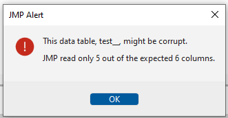

The good thing:
JMP stores the Table reference in plain text ...
By deleting the ", Auto Open" one can revive the file:
JMP will show a warning message:
and skip the details of the erroneous column.
