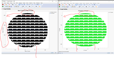

Jackie_
Level VI
Re: Offsetting X and Y coordinates of wafer
It doesn't work either Jim. See the results below
txnelson
Your axes have been reversed on one of the charts
Jim
