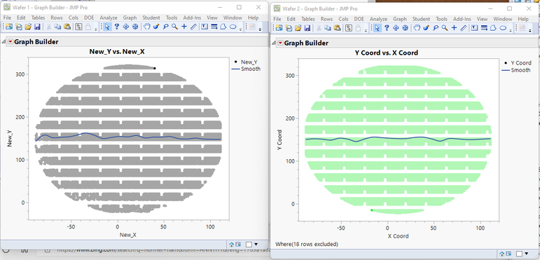

Jackie_
Level VII
Re: Offsetting X and Y coordinates of wafer
@txnelson ,
Thanks, Jim. The code works but the results isn't what I expected. You see the X and Y axis don't align with the wafer 2 Map
txnelson
I did not notice this before....the issue is you need to subtract or add the Offset from the coordinate, not the coordinate from the offset.

Jackie_
Level VII
It doesn't work either Jim. See the results below
txnelson
Your axes have been reversed on one of the charts
