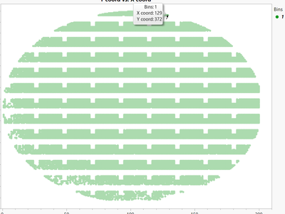

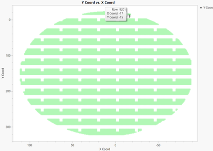

I've two jmp table which has X and Y coordinates of the wafer. I would like to know if there's a way to align the coordinates of Wafer 1 with Wafer 2?
For examples: I want to align the following highlighted X and Y with the X and Y of wafer 2.
Wafer 1 : X, Y = 129, 372
Wafer 2: X, Y = -17, -15

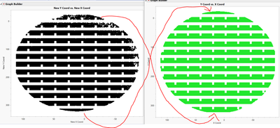

They do not match orientation wise. E.g. The top area at map 1 has Y coordinates between 0 to negative. However, in the wafer map 2 the same area is at 300 and above

I assumed that your wafers were measured in the same orientation, just with different xy origins. Apparently the total orientation can be different.  That makes the transposition more complex, but not impossible.  Do the files you read the wafers in from, contain the orientation information?

The transposition is simple math.  The issue is the determination of the orientation. The current 2 wafers appear to need to be flipped top to bottom, however, they may need to be flipped left to right also.  Looking at the pattern of empty areas on the wafer, that seems to be the case. In both cases, The transposition is to subtract each value from the max value plus 1.
