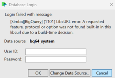

New SQL Query():
Windows user ID and password don't work in this window.

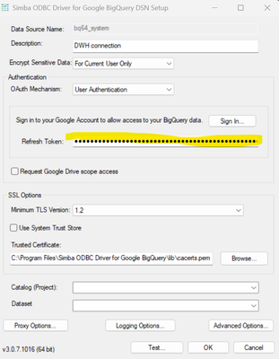

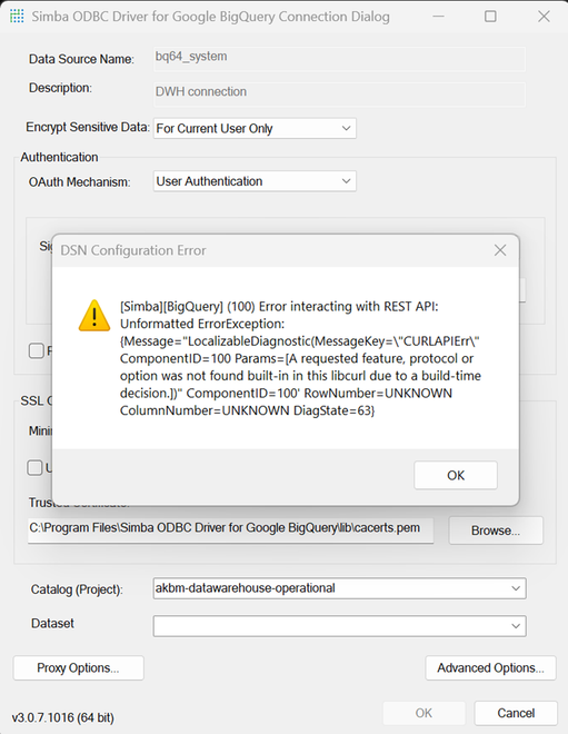

Create database connection via > File > Open Database > New Connection > Sign in:
I also created a new DSN from scratch, which didn't work either. The ODBC is not the latest version, as our IT restricts which versions we can use due to presumed bugs. Is it wrong to assume that if the ODBC connection worked in JMP 17 it should also work in JMP 18?

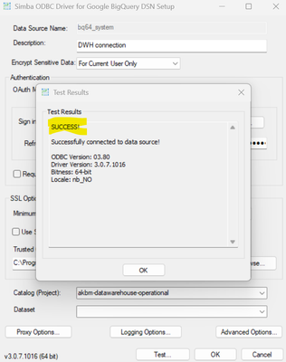

@bryan_boone, yes, I am able to connect with the ODBC manager (screenshot below). As mentioned, connection works as expected under JMP 17, but doesn't under JMP 18.
Testing the connection:
Refresh token after sign in:

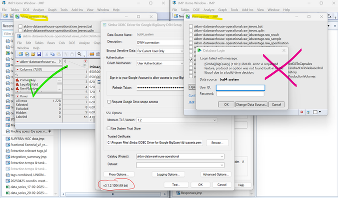

@bryan_boone @Paul_Nelson @Dahlia_Watkins, upgraded to the latest Google BigQuery driver 3.1.2.1004. No change.
Below a few screenshots for documentation:
  • JMP 17 left vs JMP 18 right
  • Both tested using our in-house “view opener” add-in, which facilitates pulling data from Google BigQuery via JSL’s ‘New SQL Query()’.
  • In the middle, proof of the ODBC driver update
I don’t understand what it requires for database login in JMP 18? Obviously, company internal user credentials are not sufficient. What else could it want?

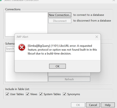

When I hit “Change Data Source… > New Connection > Machine Data Source > select my user DSN > confirm with OK” I get the below JMP alert.
