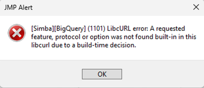

Simba BigQuery ODBC error: A requested feature, protocol or option was not found built-in in this libcurl due to a build-time decision.
The following error is encountered in JMP 18 and higher when connecting to BigQuery databases.
This error was observed when connecting JMP Query Builder to BigQuery via the newest Simba BigQuery ODBC driver. This error is related to changes in the driver released in version 3.0.5.1011. It does not occur in prior driver versions. You can obtain the 3.0.4.1008 or earlier driver release from the link previous ODBC versions.
