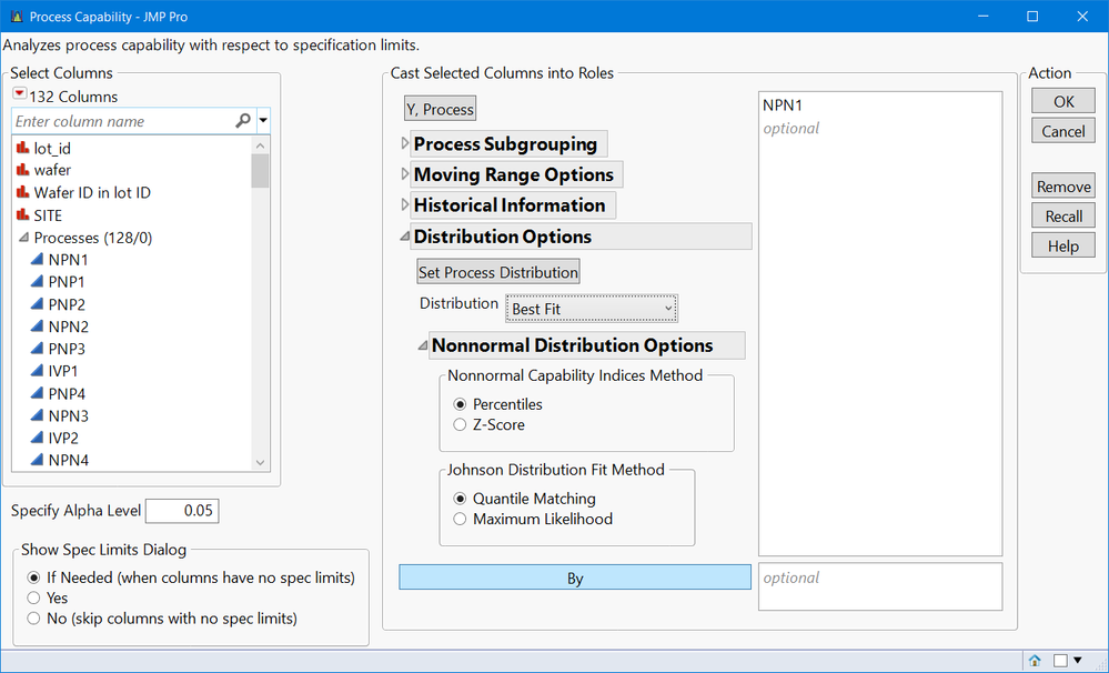

@RBAero,
You did not mention which version of JMP  or JMPPro you are using. The link below provides a step by step example if you have the Process Capability platform on your PC. You have the option to Set Distribution or use Best Fit.  PPK, using maximum likelihood estimates of percentiles is an often used choice.
Note, PPK as well as Cpk calculations, assume identically and independently distributed data ( IID ), meaning no systematic variations.
Hope this helps.
JMP Documentation for Nonnormal-capability-analysis

Thanks for the reply,
I am using JMP 14.
I did use the above method its very helpful and intuitive
Re: Non Normal Data Transformation(Capability Analysis)
I think a 'best practice' is to select a distribution model based on knowledge about the process that generates the data, rather than 'best fit' criteria. The criteria are based on a single sample. The knowledge is based on the population.
Note that if you fit the distribution in the Distribution platform, the red triangle menu for the fitted model contains a command to initiate a process capability analysis for the non-normal distribution. You do not need to transform your specification limits in this case.
