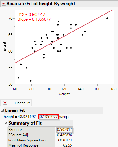

I need to extract R^2 and Slope form the report and display it on the plot itself like so:
I'm going to do this with parsing Display Trees and then looking into Add Graphics Script to the plot itself.

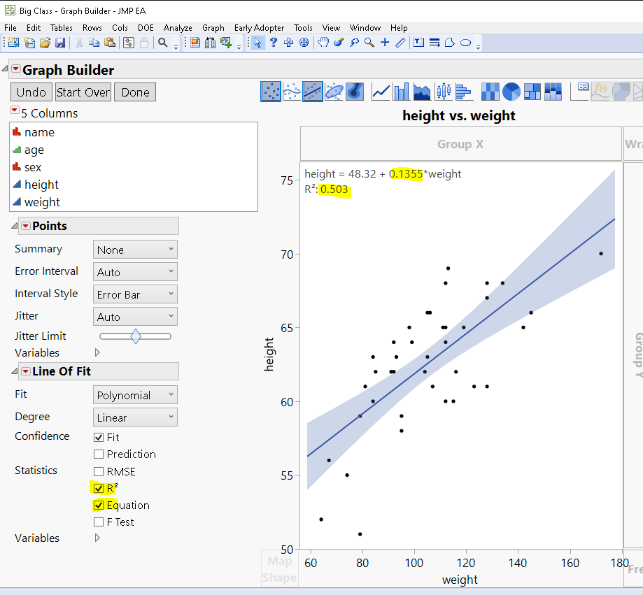

1. Is there a more straight forward way of doing that? Like Combined Data Table (which gives slope but does not give R^2) for getting number or like Line Of Fit( X, Y, Legend( 5 ), R²( 1 ), Equation( 1 ) ) in graph builder (customer wants to use Bivariate Fit)

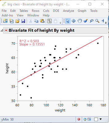

Here is an example that should get you started.
Names Default To Here( 1 );
// Open Data Table: big class.jmp
// → Data Table( "big class" )
dt = Open( "$SAMPLE_DATA/big class.jmp" );
biv = Bivariate( Y( :height ), X( :weight ), Fit Line( {Line Color( {212, 73, 88} )} ) );
Report( biv )[framebox( 1 )] << add graphics script(
	Text Color( {212, 73, 88} );
	xMin = Current Report()[axisbox( 2 )] << get min;
	yMin = Current Report()[axisbox( 1 )] << get min;
	xMax = Current Report()[axisbox( 2 )] << get max;
	yMax = Current Report()[axisbox( 1 )] << get max;
	textList = {};
	Insert Into( textList, xMin + (xMax - xMin) * .25 );
	Insert Into( textList, yMax - (yMax - yMin) * .1 );
	R2 = Current Report()["Summary of Fit"][Number Col Box( 1 )][1];
	R2 = "R^2 = " || Format( R2, "Fixed Dec", 5, 3 );
	Text( Right Justified, textList, R2 );
	textList = {};
	Insert Into( textList, xMin + (xMax - xMin) * .32 );
	Insert Into( textList, yMax - (yMax - yMin) * .15 );
	Slope = Current Report()["Parameter Estimates"][Number Col Box( 1 )][2];
	Slope = "Slope = " || format(Slope,"Fixed Dec",9,5);
	Text(Right Justified, textList, Slope);
report(biv)["Linear Fit"] << visibility("collapse");
report(biv)[PictureBox(2)] << visibility("collapse");
Documentation for the Graphic additions, and the Display Tree manipulationq can be found in the Scripting Guide and the Scripting Index

You can get really close with Graph Builder
Equation includes the slope.Equation includes the slope.
Craige
miguello
Level VII
Re: Need help writing optimal code for extracting R^2 and Slope from Bivariate Fit
Yes, I scripted that already (as I mentioned in the initial question it's easy by adding Line Of Fit( X, Y, Legend( 5 ), R²( 1 ), Equation( 1 ) ) into the Graph Builder Code), however, customer doesn't like Graph Builder for some reason and insists on using Bivariate Fit.

I need graph too, and it has to be Bivariate Fit. Previously the customer was taking a screenshot of the plot and portion of the report below to have Slope and R^2 included (basically image in my initial question without red markings). I'm automating the whole thing and I want to get rid of the report and just write those two values on the plot itself (as illustrated on my screenshot with red text on the plot).
	textList = {};
	textList = {};
