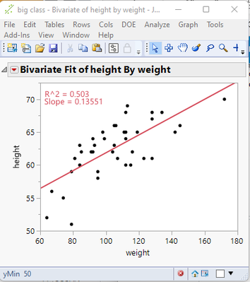

Need help writing optimal code for extracting R^2 and Slope from Bivariate Fit
All,
I'd like to ask the community to nudge me in the right direction.
I need to extract R^2 and Slope form the report and display it on the plot itself like so:
I'm going to do this with parsing Display Trees and then looking into Add Graphics Script to the plot itself.
But, since this task seems to me very standard and routine, I have to ask couple of questions before digging into Display Trees:
1. Is there a more straight forward way of doing that? Like Combined Data Table (which gives slope but does not give R^2) for getting number or like Line Of Fit( X, Y, Legend( 5 ), R²( 1 ), Equation( 1 ) ) in graph builder (customer wants to use Bivariate Fit)
2. Maybe somebody already has a snippet of code ready to use for this task?

txnelson
Re: Need help writing optimal code for extracting R^2 and Slope from Bivariate Fit
Here is an example that should get you started.
Names Default To Here( 1 );
// Open Data Table: big class.jmp
// → Data Table( "big class" )
dt = Open( "$SAMPLE_DATA/big class.jmp" );
biv = Bivariate( Y( :height ), X( :weight ), Fit Line( {Line Color( {212, 73, 88} )} ) );
Report( biv )[framebox( 1 )] << add graphics script(
	Text Color( {212, 73, 88} );
	xMin = Current Report()[axisbox( 2 )] << get min;
	yMin = Current Report()[axisbox( 1 )] << get min;
	xMax = Current Report()[axisbox( 2 )] << get max;
	yMax = Current Report()[axisbox( 1 )] << get max;
	textList = {};
	Insert Into( textList, xMin + (xMax - xMin) * .25 );
	Insert Into( textList, yMax - (yMax - yMin) * .1 );
	R2 = Current Report()["Summary of Fit"][Number Col Box( 1 )][1];
	R2 = "R^2 = " || Format( R2, "Fixed Dec", 5, 3 );
	Text( Right Justified, textList, R2 );
	textList = {};
	Insert Into( textList, xMin + (xMax - xMin) * .32 );
	Insert Into( textList, yMax - (yMax - yMin) * .15 );
	Slope = Current Report()["Parameter Estimates"][Number Col Box( 1 )][2];
	Slope = "Slope = " || format(Slope,"Fixed Dec",9,5);
	Text(Right Justified, textList, Slope);
report(biv)["Linear Fit"] << visibility("collapse");
report(biv)[PictureBox(2)] << visibility("collapse");
Documentation for the Graphic additions, and the Display Tree manipulationq can be found in the Scripting Guide and the Scripting Index
Names Default To Here(1);
dt=Open("$SAMPLE_DATA/Tablet Production.jmp");
biv=dt<<Bivariate(
	Y( :Dissolution ),
	X( :Mill Time ),
slope=report(biv)[NumberColBox(13)][2];
r2=report(biv)[NumberColBox(1)][1];
slope=round(slope,3);
r2=round(r2,3);
Eval(Parse(Eval Insert("biv<<SendToReport(
		Dispatch(
			\!"Bivar Plot\!",
			FrameBox,
			Add Text Annotation(
				Text( \!"Rsq=^r2^
Slope=^slope^\!" ),
				Fixed Size( 0 ),
				Text Box( {2, 16, 100, 70} ),
				Filled( 0 )

miguello
Level VII
Yes, I scripted that already (as I mentioned in the initial question it's easy by adding Line Of Fit( X, Y, Legend( 5 ), R²( 1 ), Equation( 1 ) ) into the Graph Builder Code), however, customer doesn't like Graph Builder for some reason and insists on using Bivariate Fit.

miguello
Level VII
I need graph too, and it has to be Bivariate Fit. Previously the customer was taking a screenshot of the plot and portion of the report below to have Slope and R^2 included (basically image in my initial question without red markings). I'm automating the whole thing and I want to get rid of the report and just write those two values on the plot itself (as illustrated on my screenshot with red text on the plot).
txnelson
	textList = {};
	textList = {};
Jim
