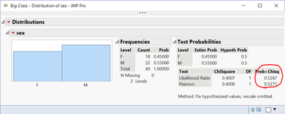

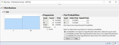

Hi
IMO, this could be test by P test.
You can find the option in red triangle "Test Probability".
Then, set your expect/Hypo probability.
Chi-S test result will be shown after click Done.
Hope it can help to sovle your problem.
Have a nice day
