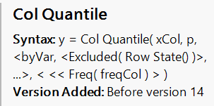

Interesting, for Col Quantiles, it's  first the column, then the Quantile.

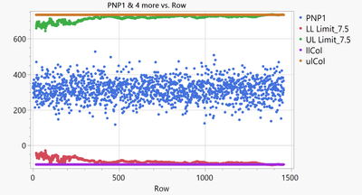

Besides that, Col Quantile will take all rows - not rows 1::currentRow
-> will result in a constant value.
