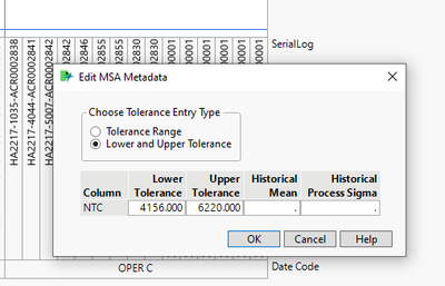

one selection for MSA Metadata while running GR&R
I am using JMP17. While doing GRR I am getting 'Edit MSA Metadata' box for each parameters. I have >50 parameters for GRR and I don't want to click ok for each parameters. Is it possible to apply Lower and upper tolerance to all parameters with one click.
I don't remember having this issue in JMP16.
