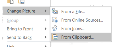

If oyu just nedd the white background now and then ...
some while ago, I found out that right click/replace picture/from clipboard will use a white background:

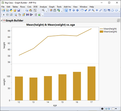

Where are you exporting from and how?
If I go directly from JMP report (graph builder in this case)
to export to PPTX
(Using JMP Pro 18.1 on windows 10).

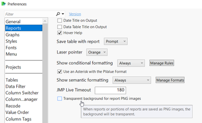

If you don't want to have they gray background at all, you can use the preferences  switch to white:
... or make the background transparent:

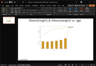

you could have a look at  Graph Builder Toolbar
It will automatically insert the image in Powerpoint - and it will add a link to the JMP file and a script to create the plot again.
If you used it once, it's hard to work without it : )

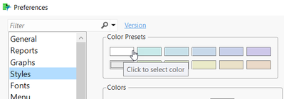

Hi,
You can set the color of the Graph Builder plots in the Preference > Platform > Graph Builder.
But maybe this is not what you are looking for.
