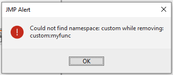

On the other hand, it's not possible to run the script a second time inside the project [to create a duplicate custom function in the project scope]. Seems JMP finds the "global" namespace and tries to delete (!!) it:
project = New Project(
		Run Script(Add Custom Functions( New Custom Function( "custom", "myfunc", Function( {x, y}, x + y - 1 ) )));
