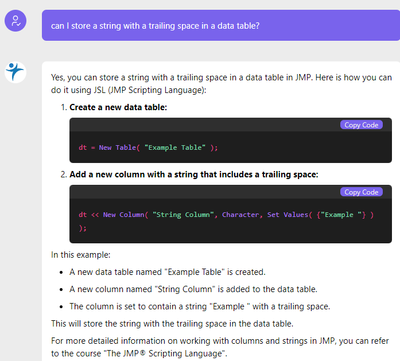

Re: Is Missing( " " ) returns True?
I guess there is a rule that trailing spaces are automatically removed from strings when saving them in a data table?
because they are hard to detect (much harder than for leading spaces).
An a simple space " " is treated as trailing space - extremely hard to be seen.
Is this rule mentioned in the documentation? couldn't find it ...
