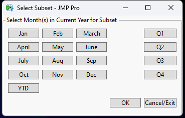

I'm not sure how your data looks like or how you do wish to perform the selections but I would separate the UI and logic. I made modifications to your UI but it isn't necessary, this just makes it a bit easier to collect the buttons. This will just demonstrate how you can build the dates from months, it won't do it for YTD or Quarters as I'm not sure how you will be using those
Names Default To Here(1);
get_dates = Expr(
	months = Loc(m_buttons << get, 1);
	qs = Loc(q_buttons << get, 1);
	ys = Loc(y_buttons << get, 1);
	// loop over as necessary to create the combinations
	dates_to_find = Transform Each({month}, months,
		Date DMY(01, month, yr);
yr = Year(Today());
subwin = New Window("Select Subset",
	<<Type("Dialog"),
	<<Size(360, 200),
	Panel Box("Select Month(s) in Current Year for Subset",
			V List Box(align("right"),
				H List Box(
					V List Box(
						lub_m = Lineup Box(N Col(3),
							Button Box("Jan"),
							Button Box("Feb"),
							Button Box("March"),
							Button Box("April"),
							Button Box("May"),
							Button Box("June"),
							Button Box("July"),
							Button Box("Aug"),
							Button Box("Sep"),
							Button Box("Oct"),
							Button Box("Nov"),
							Button Box("Dec")
						lub_y = Lineup Box(N Col(1),
							btn_ytd = Button Box("YTD")
				Spacer Box(Size(50,0)),
				lub_q = Lineup Box(N Col(1),
					Button Box("Q1"),
					Button Box("Q2"),
					Button Box("Q3"),
					Button Box("Q4")
			Lineup Box(N Col(2),
				Button Box("OK",
					get_dates;
					show(dates_to_find);
				Button Box("Cancel/Exit", subwin << Close Window)
btns = subwin << XPath("//ButtonBox");
Remove From(btns, N Items(btns)-2, 2);
btns << Style("Toggle");
// selections = Loc(btns << get, 1);
// btns[selections] << Get Button Name;
m_buttons = lub_m << XPath("//ButtonBox");
q_buttons = lub_q << XPath("//ButtonBox");
y_buttons = lub_y << XPath("//ButtonBox");
-Jarmo

	YTDList = {};
	BB1 << Set( 0 );
	BB2 << Set( 0 );
	BB3 << Set( 0 );
	BB4 << Set( 0 );
	BB5 << Set( 0 );
	BB6 << Set( 0 );
	BB7 << Set( 0 );
	BB8 << Set( 0 );
	BB9 << Set( 0 );
	BB10 << Set( 0 );
	BB11 << Set( 0 );
	BB12 << Set( 0 );
	BB13 << Set( 0 );
	BB14 << Set( 0 );
	BB15 << Set( 0 );
	BB16 << Set( 0 );
	BB17 << Set( 0 );
OKExpr = Expr(
	dt << Clear Select;
	MonthList = {};
	QList = {};
	QMonths = {};
	YTDList = {};
	For( i = 1, i <= 17, i++,
		tempBB = Eval( Parse( "BB" || Char( i ) ) ) << Get;
		If( tempBB == 1,
			If(
				Substr( Eval( Parse( "Sel" || Char( i ) ) ), 1, 1 ) == "M", Insert Into( MonthList, Eval( Parse( "Sel" || Char( i ) ) ) ),
				Substr( Eval( Parse( "Sel" || Char( i ) ) ), 1, 1 ) == "Q", Insert Into( QList, Eval( Parse( "Sel" || Char( i ) ) ) ),
				Substr( Eval( Parse( "Sel" || Char( i ) ) ), 1, 1 ) == "Y", Insert Into( YTDList, Eval( Parse( "Sel" || Char( i ) ) ) )
	If(
		N Items( MonthList ) != 0 & N Items( QList ) != 0 | N Items( MonthList ) != 0 & N Items( YTDList ) != 0 | N Items( QList ) != 0 &
		N Items( YTDList ) != 0,
		ErrorWin = New Window( "Error Window",
			<<Type( "Dialog" ),
			V List Box(
				Spacer Box(),
				Text Box( "Invalid selection. Please 'Clear' and select month(s), quarter(s), OR YTD.", <<Set Font Size( 16 ) ),
				H List Box( Spacer Box(), Button Box( "OK", ErrorWin << Close Window ), Spacer Box() )
		Error = 1;
		Error = 0
	If( N Items( MonthList ) != 0 & Error == 0,
		MonthNum = MonthAA << Get Values( MonthList );
		For( m = 1, m <= N Items( MonthList ), m++,
			dt << Select Where( :"Month Year[Date]"n == As Date( Date DMY( 1, MonthNum[m], yr ) ), Current Selection( "extend" ) )
		dtSubset = dt << Subset( Selected Columns( 0 ), Selected Rows( 1 ), Suppress formula evaluation( 0 ) );
	If( N Items( QList ) != 0 & Error == 0,
		QNum = QAA << Get Values( QList );
		For( q = 1, q <= N Items( QNum ), q++,
			If(
				QNum[q] == 1, Insert Into( QMonths, {"M1", "M2", "M3"} ),
				QNum[q] == 2, Insert Into( QMonths, {"M4", "M5", "M6"} ),
				QNum[q] == 3, Insert Into( QMonths, {"M7", "M8", "M9"} ),
				QNum[q] == 4, Insert Into( QMonths, {"M10", "M11", "M12"} )
		MonthNum = MonthAA << Get Values( QMonths );
		For( m = 1, m <= N Items( QMonths ), m++,
	If( N Items( YTDList ) != 0 & Error == 0,
		YTDNum = YTDAA << Get Values( YTDList );
		For( m = 1, m <= YTDNum[1], m++,
			dt << Select Where( :"Month Year[Date]"n == As Date( Date DMY( 1, m, yr ) ), Current Selection( "extend" ) )
subwin = New Window( "Select Subset",
	<<Type( "Dialog" ),
	<<Size( 380, 200 ),
	Panel Box( "Select Month(s) OR quarter(s) OR YTD in Current Year for Subset",
		LB = Lineup Box( N Col( 5 ),
			BB1 = Button Box( "Jan", Sel1 = "M1", <<Style( "Toggle" ) ),
			BB2 = Button Box( "Feb", Sel2 = "M2", <<Style( "Toggle" ) ),
			BB3 = Button Box( "March", Sel3 = "M3", <<Style( "Toggle" ) ),
			Spacer Box(),
			BB4 = Button Box( "Q1", Sel4 = "Q1", <<Style( "Toggle" ) ),
			BB5 = Button Box( "April", Sel5 = "M4", <<Style( "Toggle" ) ),
			BB6 = Button Box( "May", Sel6 = "M5", <<Style( "Toggle" ) ),
			BB7 = Button Box( "June", Sel7 = "M6", <<Style( "Toggle" ) ),
			Spacer Box(),
			BB8 = Button Box( "Q2", Sel8 = "Q2", <<Style( "Toggle" ) ),
			BB9 = Button Box( "July", Sel9 = "M7", <<Style( "Toggle" ) ),
			BB10 = Button Box( "Aug", Sel10 = "M8", <<Style( "Toggle" ) ),
			BB11 = Button Box( "Sep", Sel11 = "M9", <<Style( "Toggle" ) ),
			Spacer Box(),
			BB12 = Button Box( "Q3", Sel12 = "Q3", <<Style( "Toggle" ) ),
			BB13 = Button Box( "Oct", Sel13 = "M10", <<Style( "Toggle" ) ),
			BB14 = Button Box( "Nov", Sel14 = "M11", <<Style( "Toggle" ) ),
			BB15 = Button Box( "Dec", Sel15 = "M12", <<Style( "Toggle" ) ),
			Spacer Box(),
			BB16 = Button Box( "Q4", Sel16 = "Q4", <<Style( "Toggle" ) ),
			BB17 = Button Box( "YTD", Sel17 = "YTD", <<Style( "Toggle" ) ),
			Spacer Box(),
			Spacer Box(),
			Spacer Box(),
			Spacer Box(),
			Spacer Box(),
			Spacer Box(),
			Button Box( "Clear", ClearExpr ),
			Button Box( "OK", OKExpr ),
			Button Box( "Cancel/Exit", subwin << Close Window )
Thanks!,

txnelson
Re: Toggle button box or something similar
Here is a rework of your JSL.....it really isn't tested, however it should be close enough for you to use it to complete your request
Names Default To Here( 1 );
dt=current data table();
theYear = Year( Today() );
resetbb = Expr(
		Eval( Parse( "bb" || Char( i ) || "<< enable(1);" ) )
	<<Type( "Dialog" ),
	<<Size( 360, 200 ),
	Panel Box( "Select Month(s) in Current Year for Subset",
			bb1 = Button Box( "Jan",
				Sel = "M1";
				resetbb;
				bb1 << enable( 0 );
			bb2 = Button Box( "Feb",
				Sel = "M2";
				resetbb;
				bb2 << enable( 0 );
			bb3 = Button Box( "March",
				Sel = "M3";
				resetbb;
				bb3 << enable( 0 );
			Spacer Box(),
			bb4 = Button Box( "Q1",
				Sel = "Q1";
				resetbb;
				bb4 << enable( 0 );
			bb5 = Button Box( "April",
				Sel = "M4";
				resetbb;
				bb5 << enable( 0 );
			bb6 = Button Box( "May",
				Sel = "M5";
				resetbb;
				bb6 << enable( 0 );
			bb7 = Button Box( "June",
				Sel = "M6";
				resetbb;
				bb7 << enable( 0 );
			Spacer Box(),
			bb8 = Button Box( "Q2",
				Sel = "Q2";
				resetbb;
				bb8 << enable( 0 );
			bb9 = Button Box( "July",
				Sel = "M7";
				resetbb;
				bb9 << enable( 0 );
			bb10 = Button Box( "Aug",
				Sel = "M8";
				resetbb;
				bb10 << enable( 0 );
			bb11 = Button Box( "Sep",
				Sel = "M9";
				resetbb;
				bb11 << enable( 0 );
			Spacer Box(),
			bb12 = Button Box( "Q3",
				Sel = "Q3";
				resetbb;
				bb12 << enable( 0 );
			bb13 = Button Box( "Oct",
				Sel = "M10";
				resetbb;
				bb13 << enable( 0 );
			bb14 = Button Box( "Nov",
				Sel = "M11";
				resetbb;
				bb14 << enable( 0 );
			bb15 = Button Box( "Dec",
				Sel = "M12";
				resetbb;
				bb15 << enable( 0 );
			Spacer Box(),
			bb16 = Button Box( "Q4",
				Sel = "Q4";
				resetbb;
				bb16 << enable( 0 );
			bb17 = Button Box( "YTD",
				Sel = "YTD";
				resetbb;
				bb17 << enable( 0 );
		H List Box(
			Spacer Box(),
			Spacer Box(),
			Spacer Box(),
			Spacer Box(),
			Button Box( "OK",
				If(
					Substr( Sel, 1, 1 ) == "M",
						theMonth = Num( Substr( Sel, 2 ) );
						startDate = Date MDY( theMonth, 1, theYear );
						If( theMonth == 12,
							endDate = Date MDY( 1, 1, theYear + 1 ),
							endDate = Date MDY( theMonth + 1, 1, theYear )
					Substr( Sel, 1, 1 ) == "Q",
						theMonth = Num(
							Substr( Sel, 2 );
							If(
								theMonth == 2,
									startDate = Date MDY( 4, 1, theYear );
									endDate = Date MDY( 7, 1, theYear );,
								theMonth == 3,
									startDate = Date MDY( 7, 1, theYear );
									endDate = Date MDY( 10, 1, theYear );,
								theMonth == 4,
									startDate = Date MDY( 10, 1, theYear );
									endDate = Date MDY( 1, 1, theYear + 1 );,
								startDate = Date MDY( 1, 1, theYear );
								endDate = Date MDY( 4, 1, theYear );,
							endDate = Today() + In Days( 1 );
				dt << select where( startDate >= :Date < endDate );
				dtSubset = dt << subset( selected columns( 0 ), selected rows( 1 ) );
				subwin << Close Window;
Jim
