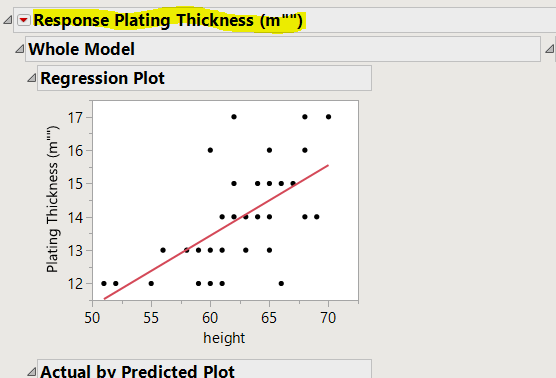

try this combination of the two answers:
colListY = {"Plating Thickness (m\!"\!")"};
dt = Open( "$sample_data/big class.jmp" );
dt:age << setname( colListY[1] );
script = Expr(
	Fit Model(
		Y( F1 ),
		Effects( :height ),
		Personality( "Standard Least Squares" ),
		Run( F1 << {Plot Actual by Predicted( 1 ), Plot Residual by Predicted( 1 ), Plot Effect Leverage( 1 )} )
Substitute Into( script, Expr( F1 ), Column( dt, colListY[1] ) );
Write( Name Expr( script ) );
Fit Model(
	Y( Column( "Plating Thickness (m\!"\!")" ) ),
	Effects( :height ),
	Run(
		Column( "Plating Thickness (m\!"\!")" ) << {Plot Actual by Predicted( 1 ),
Eval( script );
run with column substitutedrun with column substituted
Craige
