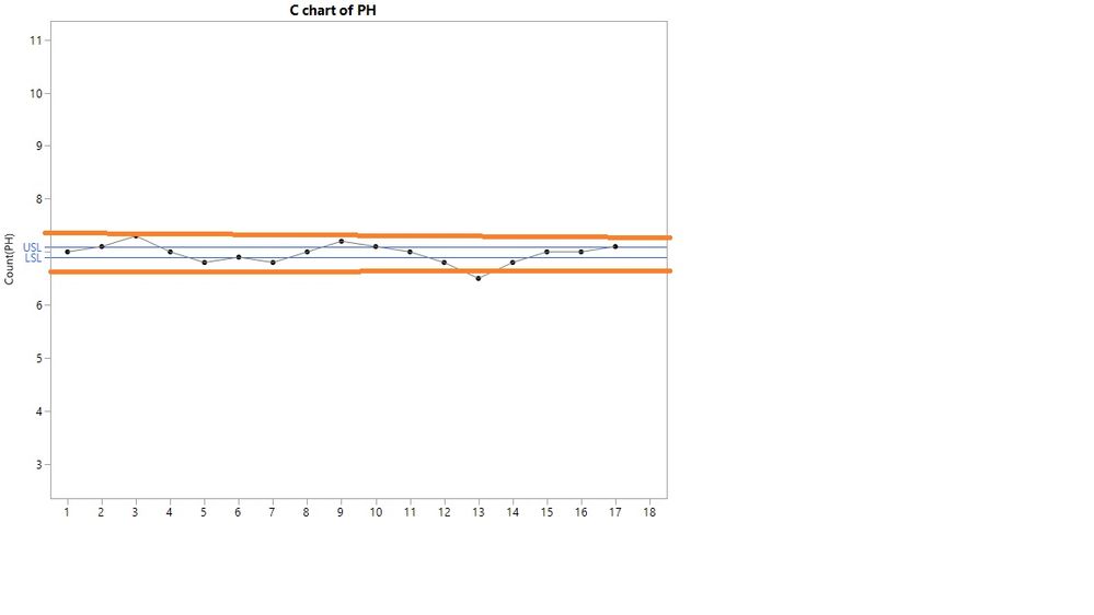

How can I add multiple spec limits to control chart builder? I have incleded an example of what I would like my chart to look like. I am not intrested in UCL and lower control limt but rather the spec limits.ex1.jpg

If you are not using a control chart, then you might make a run chart with Graph Builder and add reference lines for the specifications.

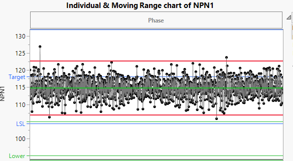

You can actually use column properties, "Spec Limits" and specify "Show Limits" to display one set of limits on your Control Chart, and set your other set of limits to the column property "Response Limits" and also set those limits to be shown on the graph as reference lines.  That may get you what you want4limits.PNG
