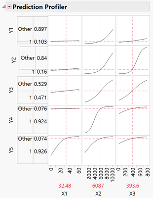

But the pragmatic approach that people will use 99% of the time is to build separate models for each of Y1 ... Y5 against X1 .... X3 and then profile them together:
These are still separate models.

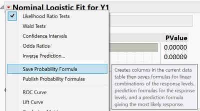

The process to do this is to save the Probability Formula for each model:

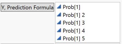

And then add the Prob[1] prediction formula column to Y, Prediction Formula role in Graph > Profiler.

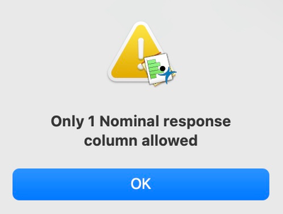

Thanks @Phil_Kay , your proposed approach is precisely what I did and what I expected to work. But JMP is telling me that I can include only one nominal response. As you might guess, my nominal responses are each in their own columns. Obviously I could stack them into a single data column and add a source label column.

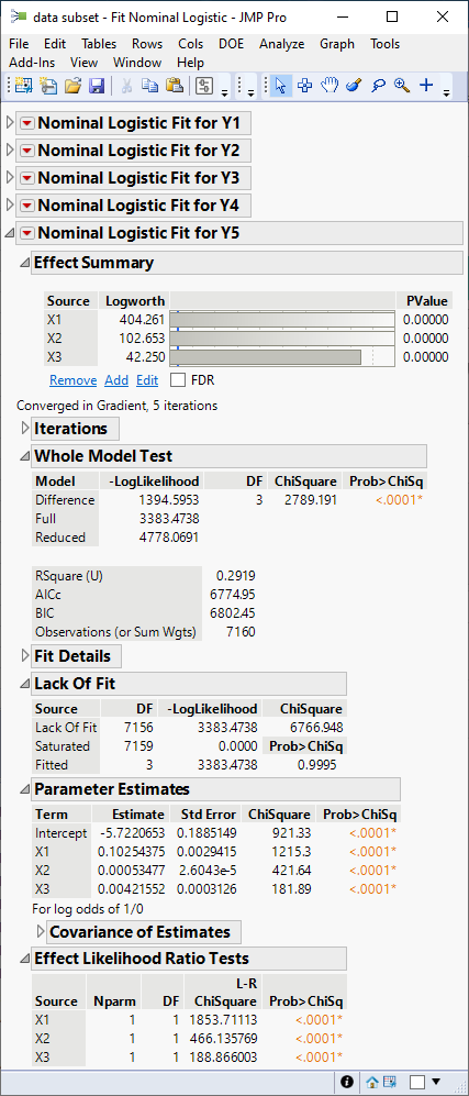

Re: Multiple indicator responses and multiple continuous predictors
I opened the CSV file in the current release, JMP Pro 17.2, and changed the modeling type of all Y columns to Nominal. I completed the Fit Model launch dialog as you indicated. I received the following results without any errors:
(Note that the report for the first four Ys is closed for sake of space.)
