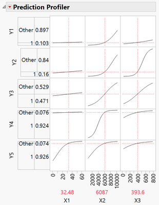

But the pragmatic approach that people will use 99% of the time is to build separate models for each of Y1 ... Y5 against X1 .... X3 and then profile them together:
These are still separate models.

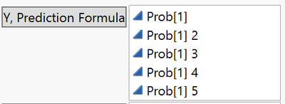

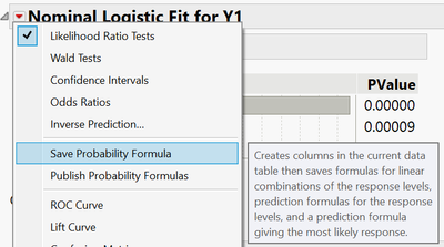

The process to do this is to save the Probability Formula for each model:
And then add the Prob[1] prediction formula column to Y, Prediction Formula role in Graph > Profiler.
