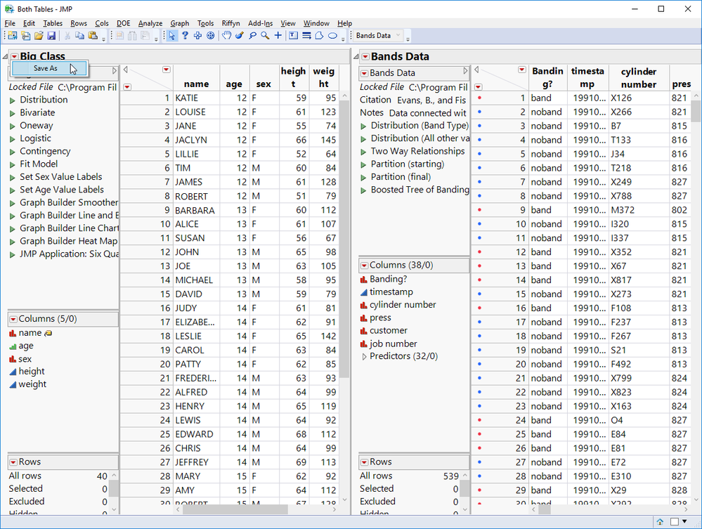

Re: Multiple data tables open
Hi @matt7109,
The menu and toolbars you see are limited to one per window. You will need to create your own custom behaviors for actions (like save) that would typically be done using the menu or toolbars.
The below script creates a red triangle menu that will save the data table within the Outline Box. Notice that I turned on the "Data Table List" in the toolbar so that you can see the current data table. With this method, you can still use the menus (Tables, DOE, Analyze, Graph) that will perform actions on the current data table shown in the data table list.

Below is a screenshot of the window after clicking on the Red Triangle Menu.
Hi @matt7109,
This is perfect!! Thank you so much !
