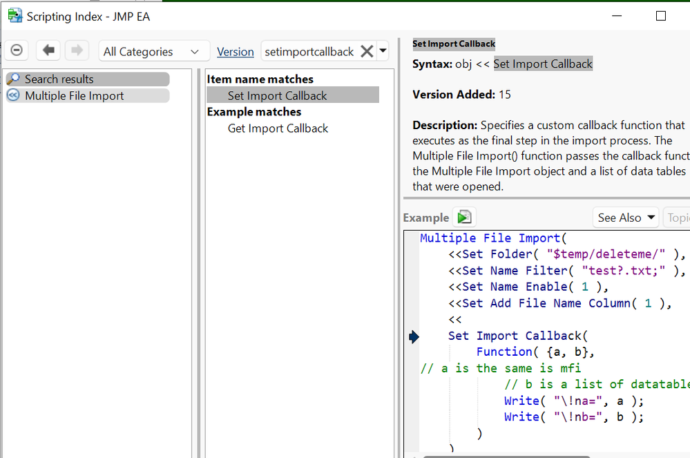

Craige_Hales
Re: Multifile Import in a script / workflow
You should be able to get the list of imported tables from the callback function, look at the SetImportCallback example.
If JSL does the <<ImportData, that also returns a list of tables. But in your case, the user presses a button and the callback is the only way to report them.
Craige

my win[ButtonBox(8)] << delete
What example are you referring to, I couldn't find it.
Craige_Hales
Make sure the category selector shows objects (or all.)
Craige
