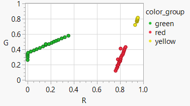

I just tried it with the below data set

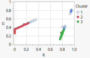

and was surprised by the result which I got with the default settings:
After some trial and error, I found the solution:
The range 0-1 has some meaning, by rescaling the columns individually, this information is lost.

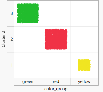

After disabling the option:
I got a perfect separation of the data points:

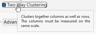

For Hierarchical Clustering, one can enable 2-way-clustering:
which relies as well on data "on the same scale". For hierarchical Clustering, "single" seems to work as well:
