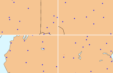

Hello,
I am working with multiple image tiles which I need to compile into single bigger image. This question has been asked earlier eg:
Is it possible to combine two pictures in one expression column?
Generic solution is to use H/V List Boxes. Here, my problem is that merged image has white line between the images which I don't want to have. Is there any way to modify List Box style not to have borders? Or some other method to do merging?

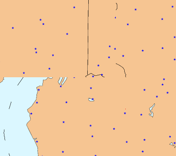

In JSL, that looks like this. Not sure what the performance will be, I don't think it will be using many CPUs.
img = Open("$SAMPLE_IMAGES/windmap.png", "png")<<getpixels;
compose = 	(img||img||img)|/
			(img||img||img)|/
			(img||img||img);
outpic = newimage(compose);
new window("no gaps", outpic);
|| is the horizontal matrix concatenation and |/ is vertical. Line 1 turns the image into a matrix.

Re: Merging/stitching images
Jarmo, You are amazing!
With your help, I was able to study this more. Apparently the issue is not originating from List boxes but from Get Picture-function. With this, borders appear to resulting picture object. However, I would like to be able to convert the List to Picture as then further manipulation (eg cropping) is possible.
So, any ideas how to get Picture without borders?
I did some testing for the performance. Getpixels - matrix concatenation method is three times faster than List box - Get Picture method. And no borders between the tiles. Very good advice. Thanks Graige!
