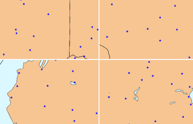

Hello,
I am working with multiple image tiles which I need to compile into single bigger image. This question has been asked earlier eg:
Is it possible to combine two pictures in one expression column?
Generic solution is to use H/V List Boxes. Here, my problem is that merged image has white line between the images which I don't want to have. Is there any way to modify List Box style not to have borders? Or some other method to do merging?
Janne

With your help, I was able to study this more. Apparently the issue is not originating from List boxes but from Get Picture-function. With this, borders appear to resulting picture object. However, I would like to be able to convert the List to Picture as then further manipulation (eg cropping) is possible.
So, any ideas how to get Picture without borders?
