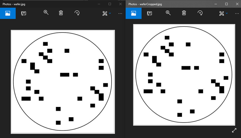

Trying to crop the light grey border from around the outside of the below wafermap image using the following script. I guess I'm not understanding how the crop message works as there is no difference in the before and after images.
Any idea of what I'm doing wrong?
Cheers, Troy

OK, so it looks like I just didn't understand how the crop function works. Fundamentally you need to know the height and width of the image you are cropping and work with those values when you crop, relative to the LHS and TOP Edges
Left = Number of pixels to remove from left side
Right = 'Width' (in pixels) of remaining image to keep
Top = Number of pixels to remove from top of image
Bottom = 'Height' (in pixels) of remaining image to keep
img = open("D:\WaferMaps\8PTPCVEB\wafer.jpg", jpg);
imgX = (img << GetSize)[1];
imgY = (img << GetSize)[2];
win1 = newWindow("Original", img);
myTrimBy = 5;
img << crop(left(myTrimBy),right(imgX - myTrimBy), top(myTrimBy), bottom(imgY - myTrimBy));
win2 = newWindow("Cropped", img);
img << savePicture("D:\WaferMaps\8PTPCVEB\waferCropped.jpg", jpg);

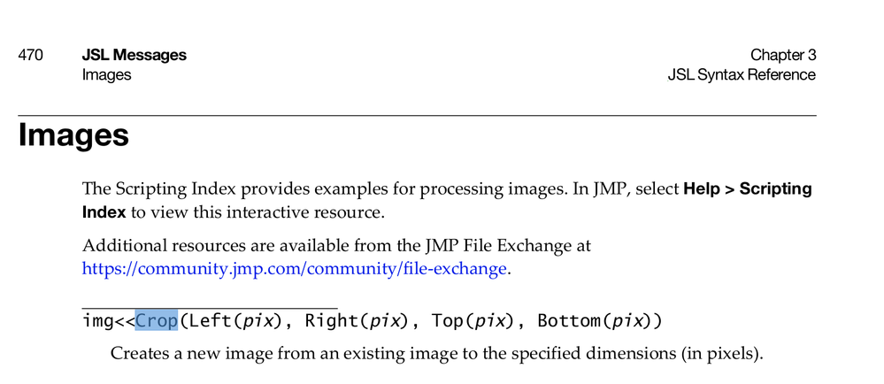

Dear @Thierry_S ,
I would have thought the same way, this behaviour is strange, as the documentation say: "creates new image ...".
But in fact crop is changing the current image, so into my eyes the documentation is not correct, it is misleading.
@tonya_mauldin , do you think the documentation has to be changed according to this?

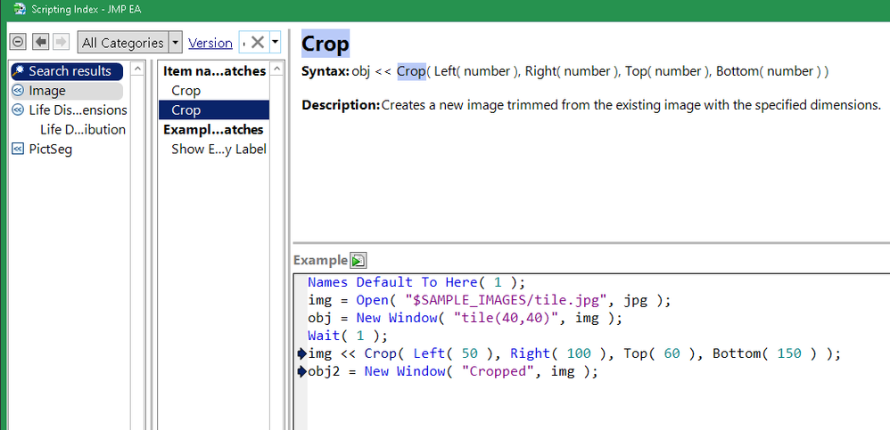

gzmorgan0
Super User (Alumni)
Re: Crop a JPG Image
Nice job. The Right and Bottom definitions you provided are not exactly as you specified. Your script is spot on!
See the script below.
Names Default To Here( 1 );
img = Open( "$SAMPLE_IMAGES/tile.jpg", jpg );
s = {w,h} = img << get size();
show( s ); //{451, 451}
obj = New Window( "tile(40,40)", img );
Wait( 1 );
img << Crop( Left( 50 ), Right( 100 ), Top( 60 ), Bottom( 150 ) );
show( s ); //{50, 90}
//img is a matrix of pixels the initail size is 1 to 451 columns aka "w" width
//and "h" is height 1 to 451 rows
//Crop Left(x) is the starting column and Right(y) is the ending column
//Top() and Bottom() works the same, so after the crop the width is 100-50=50
//and the height is  150-60=90

@Georg  pointed to https://www.jmp.com/support/help/en/16.1/?os=win&source=application&utm_source=helpmenu&utm_medium=a...
Which appears identical to the scripting guide. syntax reference.
I'd point to the scripting index:
Both say "creates a new image" but only the existing image is modified, which was part of the confusion, and neither does a good job explaining the parameters. There is another crop, for a segment, that is distinct from this one.
